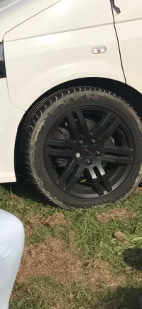

Could someone confirm that the original T5 Sportline wheels will fit on an T6 using the T6 wheel nuts, it by sound daft but I was unsure if the wheel bolts have changed in models plus I am assuming the wheels will fit.
With all the choice of wheels I decided to go mid school sportline ,not sure if I will gloss or satin black on my team Bamboo green machine.
They go on, but if you have the bigger front callipers they need spacers I have been told, nice looking wheel my favourite SL rim. As far as I am aware the T5/6 wheel bots not nuts are the same.
Yes they will fit using the original bolts but you’ll have to fit 5mm spacers you clear the callipers
Thanks all, I found a company who will supply the originals, I loved these on my T5 when I had it.
I don’t have longer bolts on mine

T5’s for me with 5mm spacers all round.
8FA8B267-2004-4841-8C2A-FE9BE7AE2EEC.jpeg 597998AD-91E6-4943-BBB8-E689F69121D2.jpeg 13E2E6B1-48F4-43F7-A053-3C9A58FD59F8.jpeg
Cheers @Deaky
What tyre sizes you running and how low?
Is the 5mm to clear brakes iirc? They fit ok with smaller brakes (mines got the smaller brakes)?
255/45 tyres. It’s on Bilsteins but I don’t know how far they’re wound down. The callipers on the back are small but I still had to fit the spacer.
Thanks.
So spacers definitely req'd, I'll just need to decide how wide (if going T5).
You had to go after market bolts too? Looks good btw :thumbsup:
Thanks.
No I used the original bolts.
