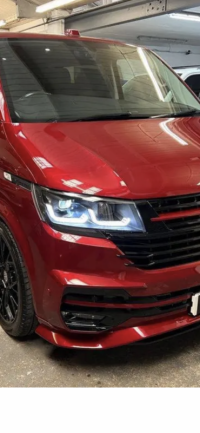

Did your van come with halogen H7 & H15 lights?Hi from Australia Two weels ago my LWB Transporter Van was delivered The worst head lights on the planet I sourced locally NARVA H 7 low beam LED headlights and then I found these for the DRL and High beam H15. They arrived in 5 days from UK and the headlights I now have are incredible No need for a light bar. All Aussie country roads here and this combination is just fantastic . Taking the grille out was easy but fitting the globes without removing the grille can also be done with small hands and a mirror You won't regret these two items Cheers AA

Oh, fair enough I know I’m making a meal out of this now but when I follow the link you provided above, the bulbs have a lead with the plug on the end so I’d figured that’s why you didn’t need the loom.The ones I got from Xenonlites went straight in and had the pins (3) on the side They sold me the loom extension which is just a 3 corded lead but I didn't use it One pin is the DLR and the other the HB I fitted all globes before I turned them on again
H7 Australian sold Narva lights and Xenonlites H 15 with no issues at all and none since in 25000 kms

I’m trying to psych myself into getting these LED bulbs - the worrying bit simply being this issue of physical access to install them.![]()

This is exactly what I got, sorry yes the 3 pins were on a very short cable I have just gone out and looked at them Hope this helps and if you play around and have small hands you dont need to remove the grille I do agree tho, why doe manufacturers have to make is so damn hard to get to things especially VW
OK, I’m going to do this, but just to be safe, which Narva H7 LED Bulbs did you get?The ones I got from Xenonlites went straight in and had the pins (3) on the side They sold me the loom extension which is just a 3 corded lead but I didn't use it One pin is the DLR and the other the HB I fitted all globes before I turned them on again

Hello mate. I’ve just installed them and finding the low beam output is a bit disappointing.
I order the same bulbs as you - with the short leads attached, but I received the ones with the pins on the side of the bulb AND THE POLARITY IS WRONG! The high beam and earth pins are swapped on the LED compared to the original halogen bulb.![]()

After a lot of mucking around, adding solder to each of the wiring loom pins, I’ve managed to get the pins to connect soundly and taped them together so they will hopefully stay plugged in. Now I‘m just waiting for nightfall so I can go for a test drive and see if it was worth the stuffing around.I order the same bulbs as you - with the short leads attached, but I received the ones with the pins on the side of the bulb AND THE POLARITY IS WRONG! The high beam and earth pins are swapped on the LED compared to the original halogen bulb.
I bought the wiring loom at the same time so I can fix it but the pins on individual wires are REALLY loose in the plug - I’ll have to tape the bloody things in place.
So after all the weeks agonising and researching so I got bulbs that worked properly, I still have to bodge it up. Grrrr.
I really hope the light output makes it worth the messing around.
