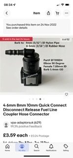

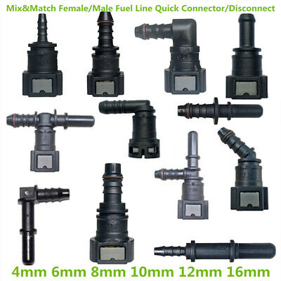

One of these 8mm Car Black Fuel Line Hose Coupler Quick Release Connect Connector | eBay like the rest of the fuel connectors. VW must have cottoned on to the fact that they are needed!
You most probably will need to reduce the size down to 4mm from 8mm with a reducer like this Inline Straight Pipe / Hose Reducer Joining Connector Plastic MULTIPLE SIZES | eBay

@oldiebut goodie I also have a T6.1 and I’m going to fit a diesel heater, so is this correct cut off the end of the nipple and the below fitting just pushes on to the nipple.
Also what will I need to connect the fuel line to the elbowed fitting.
Thank you in advance.
John.
Yes.
You just use the standard rubber heater fuel line connector the same as used to connect the fuel line to the pump/filter/heater.

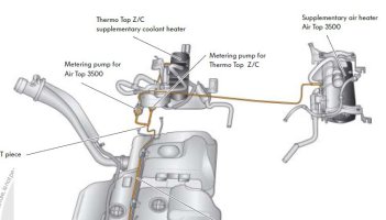

I have a T6.1 with factory fitted Webasto aux heater so there nipple shown above is already used to feed this heater. I’m fitting a (chinese) heater for air heating.
Can anyone advise whether I can tap off the line to the existing aux heater?
