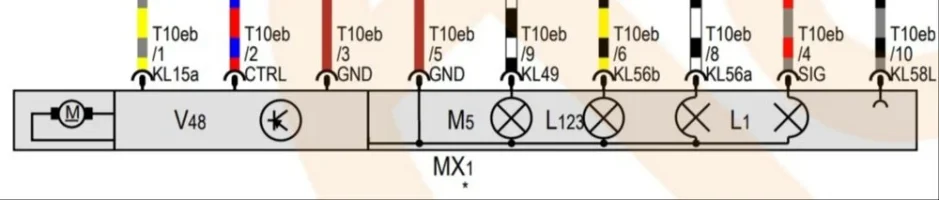

And T6.1 OEM H7 setup uses 10 pin connectors and headlamps are fed by direct connection to the BCM(no CAN).
This is similar to T6 H7 setup but with some differences. T6 H7 setup uses 5 light bulbs per headlamp and T6.1 only 3!
The wires are:
GND x 2, IGNITION 12V, MANUAL RANGE CONTROL, LOW BEAM, HIGH BEAM, FLASHER, SIDE/DRL.
