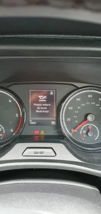

T6.1 oil level warning: Reduce Oil Level!
Matthewsn79
Any body else had this??? First happened at 990 miles AA drained the oil level then it happened again at 1060 its now been recovered at taken back to a dealship...
