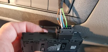

I just bought "Start Stop Memory module with SERVICE MODE! / Start-Stop SSA memory".
Color codes on T6.1 are different from T6, T5..
Does anyone know, which wire on T6.1 is signal, acc/ignition and gnd?
looks like a slight change from a T6 . . .
It doesn’t work the way "Loz" suggested (no led is blinking on module when i press start/stop button on T6.1 as shown on Start-Stop Memory Module ~ Short Description)...
As seen in the photo above T6.1 have:
BROWN
BROWN/WHITE
BLUE/WHITE
GREEN/WHITE
wires.
So is anyone 100% sure which wire is:
GND
SIGNAL
ACC/IGNITION

Have you tested the switch ?
The T6 is negative switching so you should find when you press the button the terminal that brown connects to (negative in) will give you continuity to the signal wire (negative out)
One of the cables is button illumination so you find +12v on that cable when the lights are turned on

It has been a long time that someone took interest in this post but just in case someone could still use it:
I got it working in my T6.1
At the Startstop button connector:
Brown on Brown (GND)
Blue on Green/Yellow (Signal)
The red wire i had to connect elsewhere. I could not find a wire that was suitable for this at the start stop button.
I took out the Wireless charger module underneath and took a white wire that got 12V on ignition.
!! There are 2 wires at the startstop button that recieve 12 on ignition, but whenever you use these it will not work correctly.
Everything works now.

Hi, i got it working.
brown on brown
blue on green/yellow
Red on "12V on ignition", i connected it elsewhere in the car. because the wires at the startstop button did not work.
