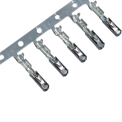

@Pauly what is the part number for the connector contacts please?
There arent any, VW dont sell them anymore, just have a search on ebay for VW crimps and it should bring up the larger JPT crimps and the small square ones required for this plug
