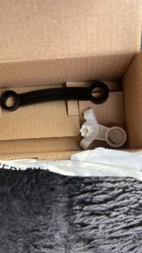

Replacement actuator arm for T6 heater controls.
Attached pic shows original white arm (not included) and a modified stronger version for a fix of a common defect.
If interested please contact Tony on 07880620367.
£35 first class signed for postage included (signature required) UK Only.

Hi the 6.1is different to the 6 but VW supply the same shitty quality replacement part, part no and part attached.
If you take the panel off above the pedals you can change the temperature by moving the bottom lever backwards or forwards to change temporarily ( have van running and up to temp) backwards cold, forwards hot.
Attached pics show the view as you look up to the left and should see broken arm on back of motor
