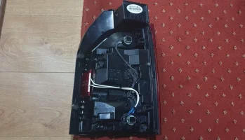

This "job" took me exactly 20 minutes including taking the lamps off the vehicle and then reinstalling them.
I simply bought 2 led sequential strips and I have inserted them through indicator bulb opening.
Specific length of the strip makes it sitting firmly inside of the lamp without anything extra to hold it in place. Seriously very simple and quick mod with quite impressive result.
One thing bothered me initially cause I thought that OEM T6 rear LED lamps have very narrow indicators and therefore sequential effect is going to be pointless.
But after quick inspection I have discovered that there is internal gap between indicator "chamber" and rear fog led "chamber" so I could proceed with this "retrofit":cool:
EDIT: Indicator strip sits partly in front of the rear fog led but this is not affecting its luminosity at all;)
I have spent €6.32 = £5.50
This is the link to my expensive purchase ----> Buy Products Online from China Wholesalers at Aliexpress.com
This "job" took me exactly 20 minutes including taking off the lamps of the vehicle and then reinstalling them.
One thing bothered me initially cause I thought that OEM T6 rear LED lamps have very narrow indicators and therefore sequential effect is going to be pointless. But after quick inspection I have discovered that there is internal gap between indicator "chamber" and rear fog led "chamber" so I could proceed with this "retrofit":cool:
EDIT: Indicator strip sits partly in front of the rear fog led but it is not affecting its luminosity at all;)

OEM T6 rear LED lights are factory equipped with 16W filament bulb for indicator.
My LED sequential strip take 0.33A, which translates to 4W.
This is obviously short by 12W to expected 16W and results with hyperflash and double frequency click in the instrument cluster.
Available coding adjustment for indicator setup is as follows
BCM 09, Byte 18
bits 4&3 = front/rear/side
00 = 21/21/5 W
01 = 21/27/5 W
10 = 21/16/5 W
11 = 27/27/5 W
The lowest possible setting is "10" which I had already as a factory setup so the only solution was to add extra resistor.
Quick maths:)
Required indicator additional power(wattage) = 16W - 4W = 12W
P = U x I ---> I = P / U = 12W / 12V = 1A ===> R = U / I = 12V / 1A = 12Ω
So required resistor is 12Ω and for adequate heat dissipation 50W seems to be sufficient.
My resistors:) ---> RS PRO Panel Mount Resistor | RS Components
Credit to @Loz for resistor type and resistor layout inspiration ;)
OEM T6 rear lights are factory equipped with 16W filament bulb for indicator.
My LED sequential strip take 0.33A , which translates to 4W.
P = U x I ---> I = P / U = 12W / 12V = 1A ===> R= U / I = 12V / 1A = 12Ω
So the selected resistor was 12Ω and for sufficient heat dissipation 50W seems to be sufficient.
