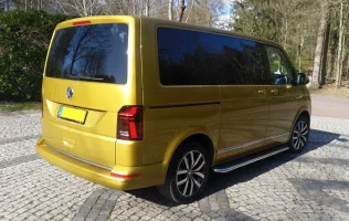

In case somebody might be just as lazy as yours truly but still wanting to do this mod Kufatec.com has a nice and easy solution.
Ordered today as well as a set of rear lights but those from ahw-shop.de who has a nice pricing compared to others.
