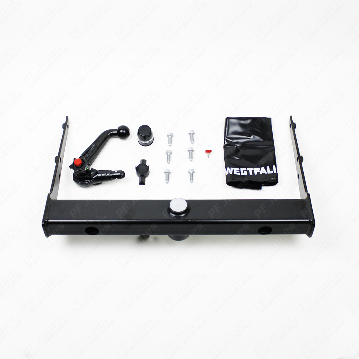

Does anyone know the load bearing rating of a detachable westfalia with bumper beam support..?
Thanks for the info... so the rack and box would tally up to 28kg.. leaving 72kg nose weight available on the westfalia.... but the remaining rack capacity as above is 51Kg...

I think there's also got to be a fair impact of weight positioning too. I assume a nose capacity of 100kg is for 100kg directly on the nose; i don't know how the capacity of 100kg is affected by loading up a rack that actually sits up to 1m behind the nose, which has got to have a fair bit of fulcrum effect on the nose. There must be multiple engineers on here that have laid in bed at night pondering this very question....

I'd be interested to know how the nose load limit actually applies to carriers and/or boxes. Obviously a trailer hitch will apply a vertical nose load based on trailer C of G as well as horizontal loads from acceleration and braking. With a load like a bike carrier that is not supported by additional wheels there must be a huge torsional load on the tow bar. The vertical weight may be low but I wonder how the tow bars are rated for twisting loads suspended up to a metre aft of their attachment....
