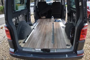

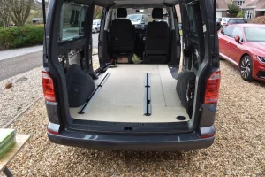

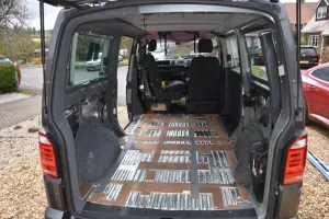

No, that won't work well. The sides of the van are sloping and the floor has square edges so you'd end up with big gaps round the edges. I laid and bonded my ply floor and then started my Karndean planking from the centre and worked out towards the sides. When I got to the edges and need to cut I used something like this to mark out the plank.
allo also said:
Also, did you install the floor first or did you carpet your van first? Our friends converted their van last year but they used altro vinyl so they carpeted the van first, then installed the plywood floor and vinyl the last. Is the process with Karndean the same or slightly different? If you install the floor planks last how do you finish the cutting edge? I can't imagine applying silicone sealant to the carpet as it would probably be a huge mess.
Yes, carpet the sides first, then the ply base and then the Karndean last. The karndean planks can be cut tight enough to the side to create a very neat edge around the floor, no need for any sealant or other trim. The vinyl plank can press into the carpet a few mm which hides the cut edge a bit, too. I actually did both on mine due to time pressures and indecision, the nearside carpet went in first, before the flooring, and the edge looks good. The offside carpet was done last, and the edge is ok, but not great, although not a concern as it is hidden by the furniture.
