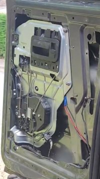

Maybe get some WD40 in the mech for the door catches at the bottom and cautiously added to the top ones with tissue to catch excess. If the internals are wedged with insulation it can possibly affect the mechanism, I know when I had mine apart for insulating that it wouldn't open when everything was back in place. If the panels will come off easily you could have a look inside perhaps. As below, these rods clip in tothe plastic and a bit of stray insulation could certainly impded them. Have you tried leaning in the door/pressing it further shut and then pulling the handle? As far as the limiter goes I think they can either be coded to be limited or there is a box - I could be wrong. If it's been remapped they may only have tested it on acceleration when it was coded, they may not have checked for a limiter. You should be getting more than 75 if it's been remapped though. Mines a 149ps and it'spretty rapid so am assuming it's been remapped as I have had 100mph out of her... on the autobahn... just outside Huddersfield...
