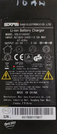

The battery is 16Ah at what voltage? Or, to put it another way, what Wh is it?
Hi.
I have taken a picture of the existing charge. Hope it makes sense to you. Thank you for your help..
Given you're likely replacing the bikes anyway, I had a google and found that a rough standard'ish capacity for a new electric bike is of the order 500Wh. At 12v, that equates to about 42Ah, which when doubled for two such bikes gives you 84Ah. Now, we can go through it in more detail but it's clear that this is going to require a very significant battery investment to be feasible (having said that, it is probably at least possible from a pure battery perspective - search the forum for a 200Ah 'Roamer' lithium battery that showed up recently). However, from a solar perspective, if we assume that, at a worst case, you'll be charging these bikes daily, you're approaching the limit of what solar can reasonably provide over the course of a (sunny!) day. If we assume a 300w panel (close to the largest size that can be reasonably accommodated), then on a day of near perfect sunshine for, say, 6 hours you can expect a maximum of 150Ah in but this will drop off extremely quickly as conditions become less than perfect and various inefficiencies in the system will detract further.
