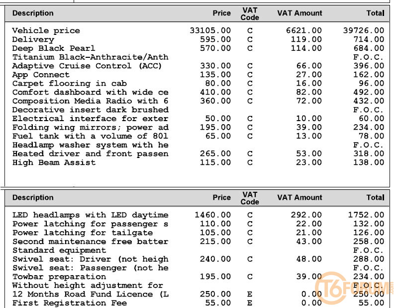

I am specking my T6 and have opted for the towbar prep.
I am a little confused as to exactly what VW provide here and wondered if anyone has specified this on a new build before and can clarify please?
In addition to the actual mounting points for the towbar and coding, I am confused if VW also include any preparation for the electrical wiring of the towbar?
Any help would be much appreciated :)
The mounting points will be there whether the van has towbar prep or not. What you get is the towing module, fuses, coding and cable running to the back of the van ready to connect the towing electrics to.
