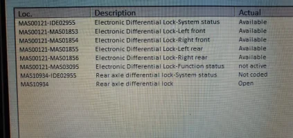

As yours is 2WD I'm a bit curious what's the status of Electronic Differential Locks now. Below measurement values (ABS controller) from a 4Motion. Just realized that I don't have a map of 2WD to compare. Just thinking that 2WD wouldn't need diff locks at rear :cautious:

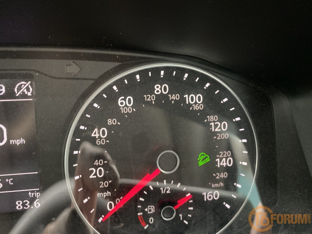

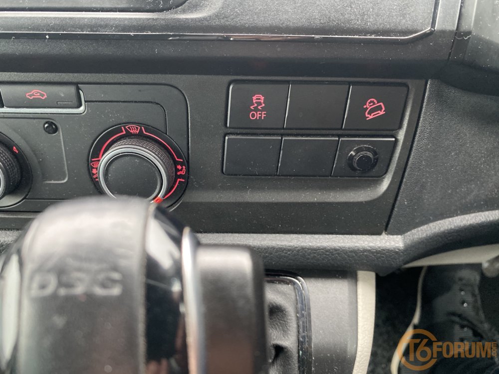

Today I finally received all the parts and got TC On/Off and HDA switches fitted/connected and can confirm both functions work perfectly fine! Thank you very much all of you for this thread. Special thanks @Robert for helping me with the wiring diagram.
Codding was done by a local specialist for £20 according to the instruction in this thread.

As yours is 2WD I'm a bit curious what's the status of Electronic Differential Locks now. Below measurement values (ABS controller) from a 4Motion. Just realized that I don't have the a map of 2WD to compare. Just thinking that 2WD wouldn't need diff locks at rear :cautious:
There you go
and as expected HDA makes no difference;)
Reactions: mmi
What does this mean? That HDA has no effect on a 2WD?
No, it just means that the EDS function is available on 2WD on the rear wheels, too.
And that is funny, because theese wheels are not driven, so a Difflock makes no sens at all on theese wheels.
