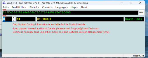

Using a bit of spare time to add more upgrades to the van and finally get round to fitting the ESC and HDC buttons that I've had for quite a while! Got everything pinned and wired as per the wiring diagrams but when trying to get into the ABS Module I keep getting this message come up on VCDS so i cant do the coding. Anyone got any pointers or advice?
You have two choices, you can either type the new coding in manually into the byte box if you know the value you want (thats highlighted with the cursor in your pic above) or you can click LCode2 on the top menu and it will give you full list of blank bits with all the tickboxes available to select
Thanks @Pauly I had tried typing it into the Byte box and amending the value but couldn't get it to work. Tried it one more time and it has done it this time!
