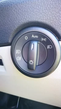

I've just had the Travelin Lite unit fitted today, need to wait till dark to test the difference, but still a bit confused re switch positions.
Switch position 1,(fully counter clockwise) is DRL only, next position is still DRL only, then final position is main beam. Full beam only comes on with stalk on steering wheel.
Is this correct?

I have just fitted transporter HQ today and they are the same. 1st position is headlights OFF - the DRLs come on when ignition is on. Next is sidelights position. DRLs stay on as your side lights but now your back lights are on. 3rd position is headlights - In this position the DRLs stay as they are - ON.
On the van-tech version the DRLs stay on with headlights but they dimmed down.

Auto light? Auto / off / on. Edit - never mind, correct answer above
Second position would be sidelights so if they're using the DRLs for that they should be on at reduced brightness. If so then I'm fairly sure that's right
Edit: I was too slow

Yes, pretty much. I had my TL headlight units fitted on earlier this week
Switch in 'O' position = DRL are On, full brightness, all the time.
Switch to 'side' light position = DRL are on and slightly dimmed, back lights are On
Switch to 'main' light postion = DRL are on and slightly dimmed, dipped beam (H7) is on, back lights are On
Steering wheel stalk (dip to full) = DRL are on and slightly dimmed, full beam (H1) is On
I have the additional wiring harness fitted which means dipped beam remains On, when Full beam is ON
Hope this helps!
Yes, the DRL becomes your side light. I'm presuming you don't have the auto light sensor switch.
