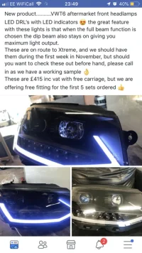

XtremeVan have posted up a Facebook message showing some aftermarket headlamps with what looks more like a neon-style DRL.
I think I’d still prefer the chrome strip running through it, myself, but each to their own..
