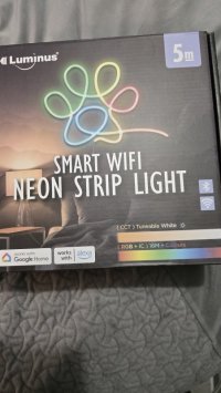

Im trying to fit a halo style strip light in the back of my van around the pop top. Bought a neon strip which will fit perfectly where I want it but I have a question about the wiring if anyone can help.
They came supplied with a mains plug, I'm after hard wiring them with a switch in the van.
Unfortunately I don't have an inverter.
I've attached a photo of the back of the plug and was wondering if a 12v to 24v DC step up converter unit will work for powering them?
I only know basic wiring and this is above my pay grade.
Any help would be appreciated

Would it not be easier to send those back and buy some that use 12V instead?
Probably, but I've got them now and it's a hassle taking them back to the shop. Plus they are exactly (bar the voltage issue) the ones I'm after that change colour ect and the right fit for where I want them. For the sake of a few quids worth of parts there will be a way to make it work, I just need someone smarter than me to tell me what that is and what I'll need.
How much were they? I'd be inclined to get a 12v set and use those in the house somewhere. You'll probably spend as much getting them to work as buying another set.
Only £30 from Costco, not worth the round trip to take them back. If I can't get them going I'll just stick them in one of the kids bedrooms.
The main reason I wanted them as they are a single strip of lights instead of lots of little visable ones and work on Bluetooth via app on the phone to change the colour and dim ect, I've not been able to find any that do the same in 12v when I've been looking. All the 12v ones seem to be single colour.
