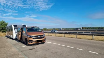

  • Between Year 1 and Year 2, I had furniture fitted into the van by Ply Guys (floor and two units, one with a big slide out drawer). The van was fully loaded for the trip.
  • The issues mainly occur when the van is under heavy load and in hot weather.

(Picture of outfit for reference)
I'm surprised VW replaced the turbo under warranty on a remapped van, you were lucky.
Anyway, did they show you the old turbo or explain in what way it had failed?
Is it possible that the old turbo was OK and that changing the turbo didn't fix anything, but you didn't put the engine under such load again until this holiday?
I'm wondering if your intercooler has failed, if it has a small hole in it that only causes issues under certain conditions, i.e high load.
