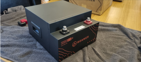

cool have a look at the ROAMER SB230SB lithium.
@RoamerBatteries
fits under the seat perfect.
Thanks Dellmassive but the coffee budget would be well and truly blown at over a grand for a ROAMER SB230SB lithium ! .... there must be another way ....

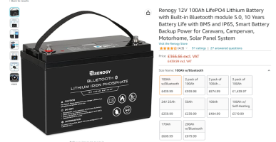

the Renogy above is rated at 100A continuous discharge.
Renogy recommend one 100ah lithium per 1000w of inverter.
so 2x 100ah lithiums will give you the 200A discharge rate for 8000 cycles etc. ( recommended for a 2000w inverter)
pulling 1400w or 130A from one lithium might trip the BMS saftey cutoff.

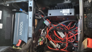

i run the 230ah lifpo4 and have 2k inverters, but struggle to fit them under the seat bases due to size,
so for now im running a 1000w Renogy inverter,
ill build a box for the back at some point to house the larger 2k inverters, and may look at moving the battery to back as well so i can refit my under seat sub.
