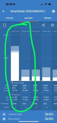

So if this is the day you moved from your storage location into a place with better visibility of the sky you can see how much of a difference that's made to your solar yield.
An important figure to look at here is "P max" as this is the highest overall power the panel achieved. I'm assuming from the figures you have a nominal 100w panel, so on the "2 days ago" you got very close to ideal with a peak power of 90w, but the days before you got very low values in the 10-15w region.
Shading really harms solar panels, more than you'd expect. I did some experiments myself here:
