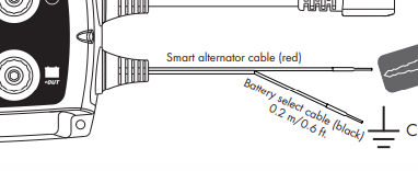

Thanks, just to confirm, I'll just run this battery select cable shown below to the neg bus bar or to the van chassis common - or either, or does it have to go direct to the Fogstar?
If you connect it to negative you'll set AGM profile - which is what you have now - you want to connect it to +12v to select Lithium profile

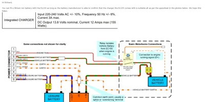

Hi all - update from Sargent and Fogstar below. I guess my only real option now is to find a replacement charging solution and leave the Sargent in place to run the 12v systems? Any advice welcomed please - thanks.
WhatsApp_Image_2023-12-04_at_09.36.20_39708ea0.jpgDave (Fogstar Ltd)
2 Feb 2024, 08:41 GMT
Hi Rik,
Unfortunately, it looks as though this may not work, as the specs on the charger show a 13.8v charging current. We generally recommend 14.4v for bulk charging, and 13.8v for the float. This Sargent unit may work for topping up the batteries on a float charge, but I'm not sure that it will provide enough voltage to give a Drift battery a full charge.
Kind regards,
Dave
Have you changed the CTEK to a lithium capable one?
One option is to just do that and see if that's enough to support your needs.
If you get enough from the DC-DC charger you can just leave the Sargent charger off (pull it's fuse)
If you find that you spend a few days on EHU and don't do enough driving for the DC-DC to keep reasonable levels of charge in the Fogstar then you can try leaving the Sargent charger on. Fogstar seem to be happy with that as float charge and it will provide something like 8amps to support your loads (so you won't take that out of the battery) - potentially that's actually a very gentle profile for a lithium battery.
If none of those work for your use then consider an external mains EHU charger like a Victron - but you may find it's not needed.
