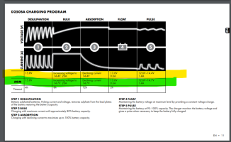

i still wouldn't use a D250sa myself (unless you perfectly understood the mechanics of whats going on)
(The D250SE does have a lithium profile)
step#1 could pulse 15.8v to a lithium which is too high, but should trigger the over voltage protection.
then AGM setting could give 14.7v to that battery - again to high - but with volt drop and short durations the battery may see 14.6 or 14.5v
SLA setting could give 14.4v - which is what FS are referring too.?

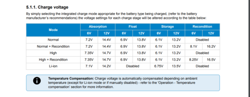

as a reference, the Victron kit uses 14.2v BULK for the 80% odd - then 13.5V FLOAT for the remainder for the default Lifepo4 profile.
but these settings can be tweeked to the 14.4v bulk & 13.6v float called for by FS.

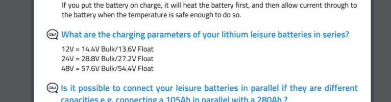

and for reference, the Fogstar calls for 14.4v bulk & 13.6v float

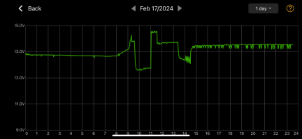

IMG_4631.pngNot sure if this helps but you can see here from around 3 when we connected to the mains. It should happily trickle along at 13.5 until we unplug on Monday

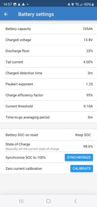

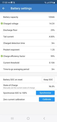

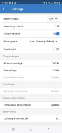

I am pleased to say that the Sargent has stopped alarming and all seems to be ok on that side of things, however, there is still an issue in that when I switch on the Sargent and come back to it in the mornings it has switched itself off. It does this every time I switch it on and leave it unattended overnight (So can't see when exactly it is going off). Is there anyway of tracing this issue? I have attached a couple of screen grabs of the battery settings on the Victron app in case these are incorrect causing any issue. Any advice welcomed - thanks. Rik.

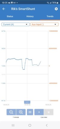

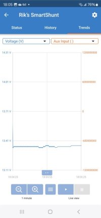

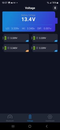

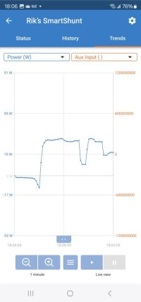

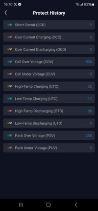

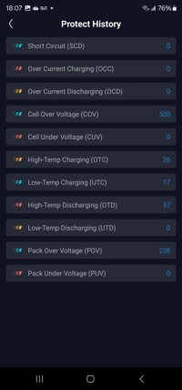

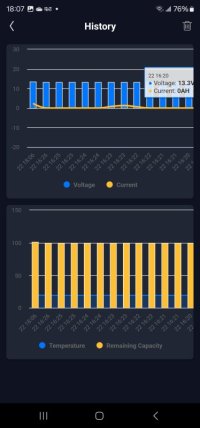

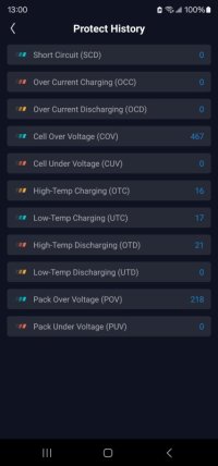

Installed the CTEK250SE and the alarming issue I was experiencing has stopped, but now I seem to have another issue. At random times the Sargent is making 2 audible beeps and then powering off. When on EHU it doesn't do this. I have attached the details from the Victron MPPT, SmartShunt and Fogstar App at the time of shutdown (18:04) and also shots from the Fogstar app Protect History earlier in the day (1pm and 4pm). At the time of shutdownFogstar Battery Status - 6pm.jpgFogstar History.jpgFogstar PH - 1pm 22 June.jpgFogstar PH - 4pm 22 June.jpgFogstar PH - 6pm 22 June.jpgSmartshunt Current.jpgSmartshunt Power.jpgSmartshunt Voltage.jpgVictron Battery Settings.jpg I was only running the 12v fridge. I haven't changed anything on the system apart from installing the Lithium Batery and the 250SE. Any help appreciated as I don't want warm beers in the morning at Glastonbury next week lol!
Generally a compressor fridge isn't wired through a system like the Sargent, they tend to need a fairly direct connection to the leisure battery to avoid voltage drop issues?
