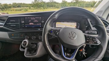

Hi all, I had my composition Media upgraded to discovery yesterday by MPVAG ( Highly recommended) which integrates superbly with my virtual cockpit. One question I do have is regarding the sharkfin; are they all the same on all t6.1's and is there a separate gps antenna for the discovery unit or is it built into the control box. tia
GPS aerial is in the wing mirror. Shark fin (aerial front centre of roof) is LTE aerial for the SOS button / function
