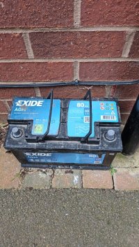

I'm not sure whether they've supplied me with the wrong battery again, or whether the theory of it being a drained battery is true. Any help or thoughts appreciated! I will attach a picture of the Battery that came out of my Van first time round (which worked fine until it died naturally over the winter). and I'll also attach picture of the new battery they supplied me.
I notice the one that came out the Van had AGM written on it, and the new one doesnt, could that be something to do with it?
You want an AGM battery and also 80Ah like the original. The replacement is a lower capacity at 70Ah. I’d get your money back and go somewhere more reputable who can supply the correct battery.
