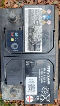

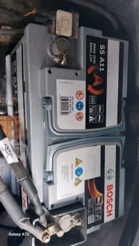

Hello. So just swapped my OEM starter battery for a new Bosch AGM battery as battery tests show it was pretty much dead.
Anyway, fitted ok. How do I code it in using OBDeleven? I would have thought there would be a nice barcode I could scan on the Bosch like there is on the Varta, but there isnt.
How do I find the module on OBDeleven where i enter that it is AGM (or fleece as it seems needs to be entered).
What code would I enter tfor the new Bosch battery? What is the vendor code for Bosch.
Any help would be much appreciatednew bosch battery.jpgold varta battery.jpg
Any help would be much appreciatedView attachment 215546View attachment 215547
