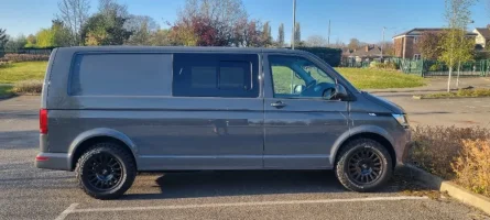

Hi, I have a T6.1 and have recently gone from 205 65 16 clatons to 235 65 17 oz rally raids with bfgoodrich tyres. I want a usable spare to carry on a journey if I get a puncture etc. Can anyone advise if fitting a tyre with a slightly smaller diameter make a difference I.e. a 215 60 17 davenport or vw steel in the pic. I want the spare to fit underneath in its normal position as I have a tailgate with a bike rack mounted so rear mounted isn't an option. Also will the davenport or vw steel wheel still fit with a altair rib fixing bracket which I'm fitting next month?. Cheers.
A 225/75 16 puts you within 1% difference so woukd be suitable as a spare.

That makes more sense 👍. I don't know if this sounds stupid as I'm quite new to this, but would the 225 75 16 tyre go on the 215 rim? I'm asking as these rims are readily available and have the correct PCD.
If it's any reassurance my 6.1 was a demonstrator and the dealer ordered it with 18 inch Palmerston wheels and a 17 inch steel spare and fitted tyres to be close to same diameter as you suggest.
