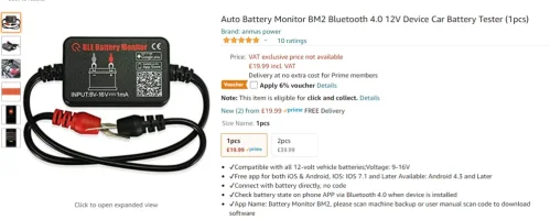

battery monitor arriving tomorrow....

They’re useful, but if you have access to a DC clamp meter it’s worth checking the drain in mA aswell as the voltage drop. :thumbsup:
