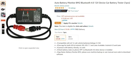

these readings above are from a BM2 battery monitor connected to the starter battery:
Auto Battery Monitor BM2 Bluetooth 4.0 12V Device Car: Amazon.co.uk: Car & Motorbike
amzn.to
