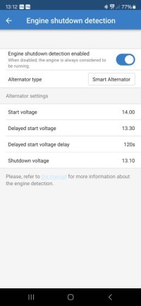

I have a Victron Smart 12/12/30 isolated charger and the van has a smart alternator. Both negatives on the isolated smart charger are connected to ground (not sure if that makes a difference - but wanted to check).
Smart charger is not detecting the engine has started. Looking at the app when the van is started, the engine start is not being detected. Occasionally it does whilst driving (i assume when the smart alternator kicks in more (13-14v).

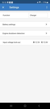

I've read some posts about some sort of "connection to a fuse/ignition" to enable the smart charger to know the engine is on. Can anyone please help what this is and where it should be connected to the Smart Charger? OR....is it the settings I have in the app (shown below) which are not being "smart"?
Screenshot_20240527_131212.jpgScreenshot_20240527_131205.jpgScreenshot_20240527_131221.jpged the
Your can twerk the Auto detection settings to pickup the lower engine running voltage.... That's what I done.
You can also run a IGNITION feed or Engine Run.
But start with these settings for now...
I'll add pics...
See the engine shutdown etc settings.
13.10v
13.05v
120sec

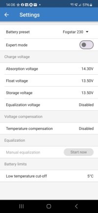

Screenshot_20240527_140603.jpgScreenshot_20240527_140616.jpgScreenshot_20240527_140622.jpgScreenshot_20240527_140634.jpg
Isolated chargers are not needed on a grounded body vehicle like a T6, so it's fine for both negatives to be connected to ground (so long as they both are)
The settings from your app look plausible, note that if you've just started the engine you'll be in the delayed start section so it will wait at least 2 minutes (120 seconds), this is to ensure the charger doesn't put a load on until the engine is running stably.
I'll add pics...
13.10v
13.05v
120sec
12.99v
View attachment 242963View attachment 242964View attachment 242965View attachment 242966

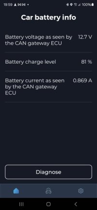

I was using Carista app to monitor car voltage. Oddly battery hovered between 80% and 85% in the app...oddly it didnt just "go up". never more that 85% on the whoe 2hr journey. It's a new "ish" battery....so just put it on seperage charge when got home to see if any issues there.

That's totally normal and well documented behaviour for a start stop vehicle battery, the "gap" is left for regenerative braking to recover energy.
If you charge it at home all it will do is fill the battery and then the van will let it drop back down to that level before it charges. If you charge it at home do not place the negative of the charger on the battery terminal, you need to be the other side of the shunt, otherwise you will charge the battery in a way that's not seen by the van electronics and things will start to get confused, possibly leading to over charging of the van battery.

These are the settings you need to change.....
To reduce the voltage point that the charger wakes up at.
13.1v works on my van .. but you can't go lower is you wish.
