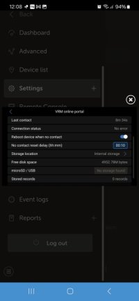

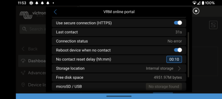

Yeah I don't use any WiFi on the Cerbo, its notoriously bad - I just use the ethernet connection on the van router. The vrm connection literally uses a few GB a month at the very, very most (my average usage when not using the van is about 400MB a month!).
If you haven't already, I'd suggest checking the option to reboot if no connection to VRM (mines set to 10 minutes), a few times before this was set it'd lose connection and a reboot sorts it 99.9% of the time. This just does that automatically!

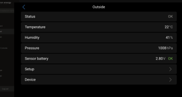

I thought it was about time i added the other RUUVI temp sensors, to the Cerbo GX-S in the Bus,
now one stuck to the LB,
one for Outside temp
one for Inside Temp.
its super easy to add devices now with the New GUI, . . . .
