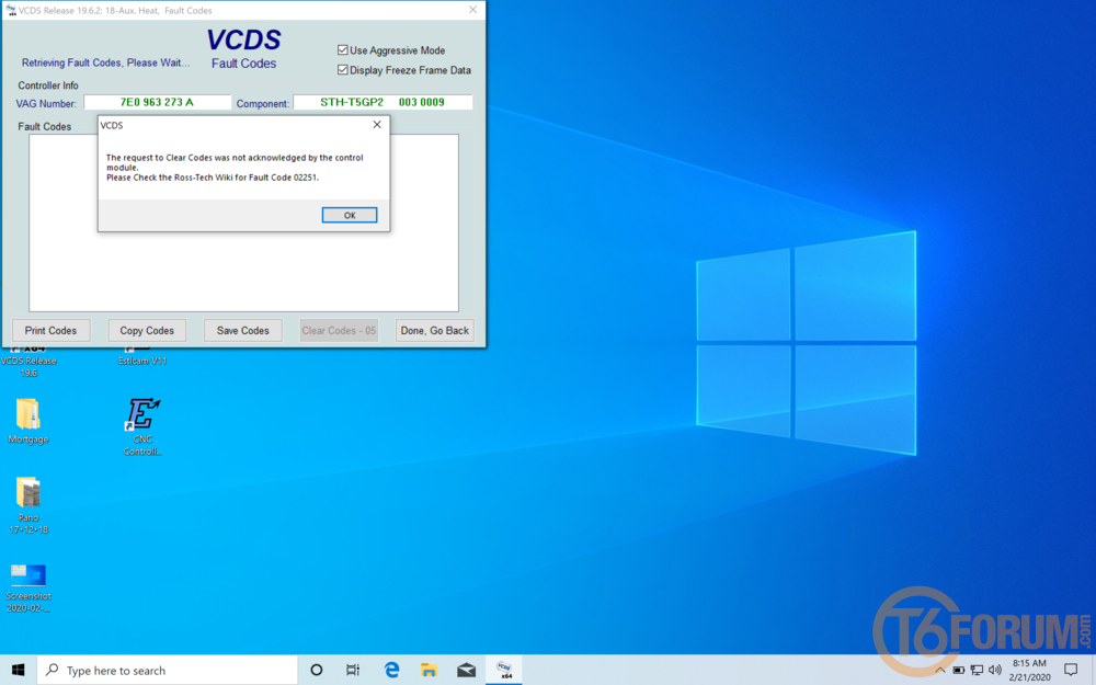

I have gone to the security access and entered the code.
These are my Error Codes

@mmi it reads 'active'
I have tried changing to inactive and back but that didn't change anything.

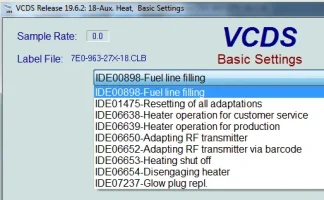

You could try under Basic Settings -> IDE06654-Disengaging heater
It is said to work on MQB platform vehicles (which T6 is not though but there are similarities).

With regards to basic settings, I can't find this on my Ross-Tec app.
Should be under module 18 (Aux.Heater).
VCDS -> Select Control Module -> 18-Aux.Heater -> Basic Settings -> IDE06654-Disengaging heater
@mmi You saved the day. Using Basic settings under Disengging Heater, with security access already activated the codes have now cleared. I tried running some function testes but noting was happening via VCDS. I suppose I'll have to wait until the engine is cold and temp is below 5 degrees.

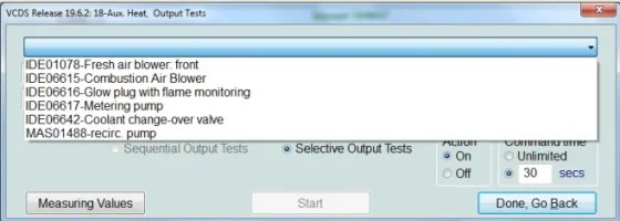

Did you run the tests through this menu "Output Tests"
The following tests should run at any temperature - and are easily heard.
- Combustion Air blower
- Recirculation pump
- Metering pump

I ran the test via output tests yes. But none of them seemed to do anything except for the metering pump (sounded like a relay under the dash engaged) but that was that. Waiting for temperature to drop below 5 degrees now. I haven’t much of an idea why it’s 4391. Anything I can look into about this ? Don’t think I’ll jump into the remote setting just yet. Not until I get it working as it should anyway !

manually priming the fuel. I can’t find anything similar on VCDS
Perhaps this one under Basic Settings?
What bothers me a bit that you couldn't start the Combustion Air Blower through output test.
