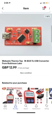

Nice to see that there is further help with VCP - we will all end up with so many dongles for this, that and the other we will lose track of what each ones limitations are.
