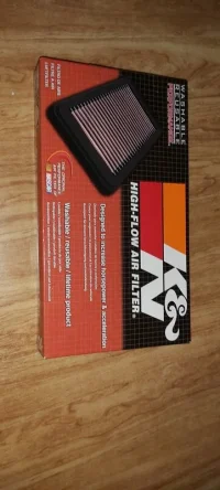

Reminds me of my old Honda Civic vvtl-I what a car that wasI did it! I've gone back to my boy racer days... Yes it does make that sound we all remember it certainly has a noticeable performance increase going through the revs, not too sure about the improved mpg it's claims but chuffed with it
