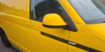

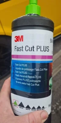

So want to be able to machine polish mine got some light scratch’s shows up on cherry red but it scares the shit out of meQuick clean up of the van and the other toy... Painted and fitted the new mirror cover after losing one in Wales recently.View attachment 134479
I first learnt on a freshly painted car. Spray water on the paintwork, compound polisher on not to high a speed and go light on the pressure when buffing. It's all a learning process but isn't as scary as you think once you are going. Think of it like anything else it doesn't hurt to do multiple light passes but if you go to hard the only way of putting the stuff back on is with a paint gun.So want to be able to machine polish mine got some light scratch’s shows up on cherry red but it scares the shit out of me
