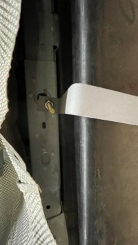

So I was looking at using the space on the right side, and building a water tank out of 125mm PVC pipe, 2 stacked on top of each other. With a drawer system so I could pull it out if there was any issues. That would give me around 20l of water. There's no pre made tanks that are narrow enough to fit that space.
However, just the 2x 1 metre lengths of pipe, and 4x end caps, comes to £145! That's before any extra fittings to connect the 2 pipes, the hozelock inlet system, clamps top hold the pipes, drawer runners, or making a breather pipe...
The complete 70l underslung tank, with a hozelock backfill attachment and fitting brackets comes to £185 all in.

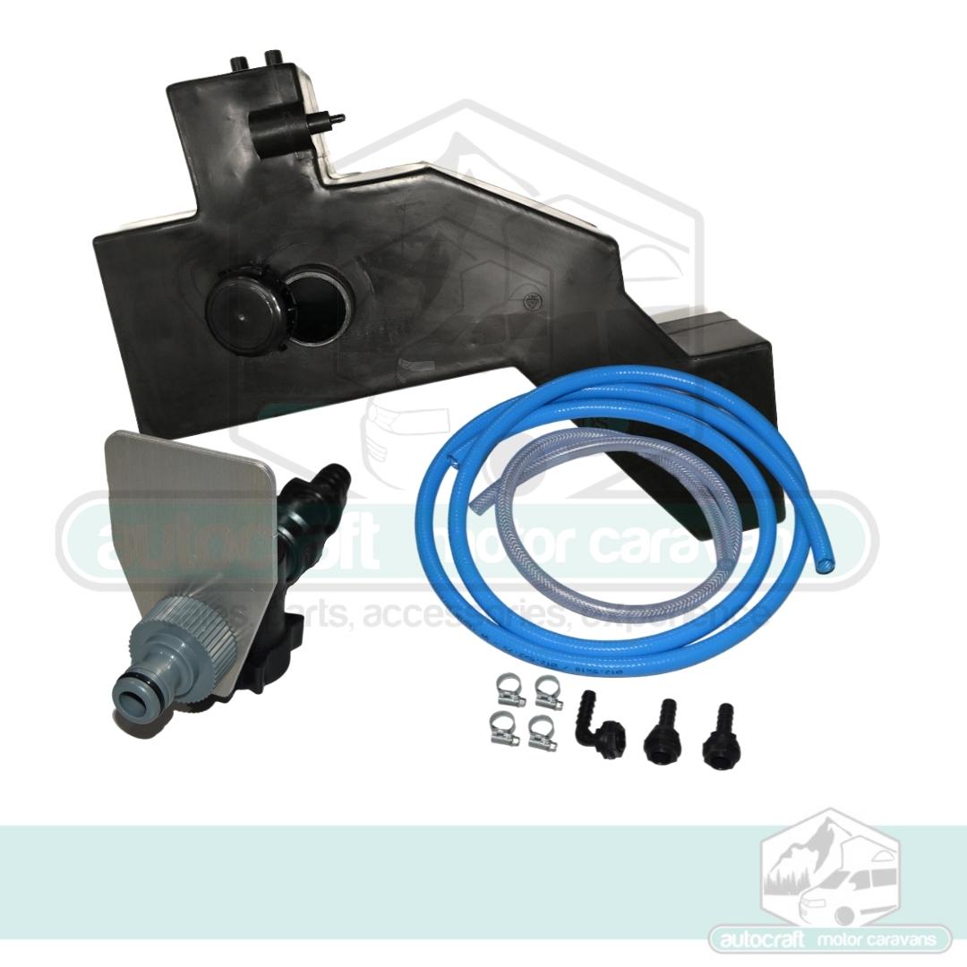

VW T5-T6.1 60L Fresh Water Tank kit with Hozelock filling system
Get your fresh water kit from Autocraft Motor Caravans. The 60 Litre Tank fits all VW T5, T6 and T6.1 models, and comes with a backfill system for easy installation.
This would also give me extra water over the 16l fresh tank under my sink, for times when I'm off grid for more than a few days, I could fill it up from the underslung tank.
Anyone fitted one of these and if so, how much of a b*****d to fit are they?
