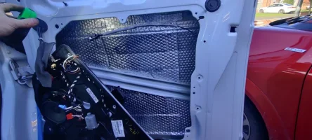

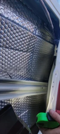

Well today I made a start on sound deadening my T6.1 front doors.
First I removed the door panel and window regulator and annoyingly broke 3 of the door clips - are the ones available on Amazon any good?
Then I thoroughly cleaned the inner metalwork with some brake cleaner, however there was so much wax at the bottom of the door I left this.
I then applied my dodo mate deadn hex to as much as I could except the bottom 3 inches of the inner door skin.
I also did as much of the regulator panel as I could but will show them photos when I renew the panel clips.
Hopefully do the passenger side tomorrow, the difference it's made to the door closing sound is fantastic!
