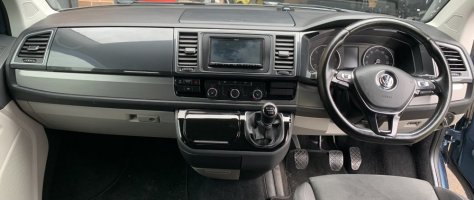

First of the 2 LED lights strips installed.
What's that dimmer switch hanging from where the grab handle used to be? I hear you ask. Well, a week ago I was sat in the van trying to figure out where to put the dimmer switch for these lights, without altering the interior too much. C pillar was an option but it's too far from the door, and there's no enough room behind it, so I'd need to mount a panel.
Then, it grabbed me. Or rather, I grabbed it...
The grab handles above the doors have nice solid mounts into the chassis, and would mean zero modifications to the van. So... :D
It needs finishing off, but this isn't the only one I'm going to make. ;)
I need to mount a Renogy One Core somewhere, and I've got an idea for the drivers side grab handles above the kitchen and window bags. Watch this space. :cool:

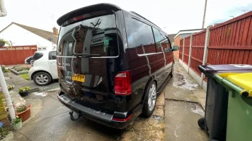

Washed it and started to repack it ready for our road trip through Wales. We've got rid of a load of stuff that we have just accumulated in the van to make room for the stuff we really need, plus we've got our new folding bikes that are coming with us inside the van. I don't suppose the van, or the bikes will be this shiny by the time we get to the Bala forum weekend

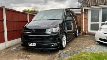

Van is 5 years old in a couple of weeks so gave it a pre-birthday wash and polish as the sun went in this afternoon.
Still pondering new wheels :whistle:
