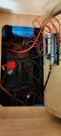

They weren't covered when I bought the van. Only thing that's been added to the terminals is a connector for the diesel heater. Which has been on over a year."Lion" is a potentially very confusing brand name for a conventional lead acid battery...
But your settings look fine
Hopefully those post terminals are normally covered?
Only thing I would recommend considering is that your battery terminals are very crowded and several of those circuits don't obviously look fused. You might want to consider moving to a bus bar or sub fuse box so it can be a bit tidier and have a master fuse. At the very least consider using the multi terminal battery clamps:
Positive Battery Terminal Clamp - 3 Stud Connection
Battery terminal clamp for positive post with 3 stud connection points (2x M6, 1x M8) and nyloc nuts. Ideal for multiple auxiliary connections.www.12voltplanet.co.uk
Will have a look thanks.I'd recommend trying to find something to at least cover the positive post and terminals, it's very near grounded metal and should something short it's going to get hot very quickly under that seat and being the post no fusing would cut the power.
