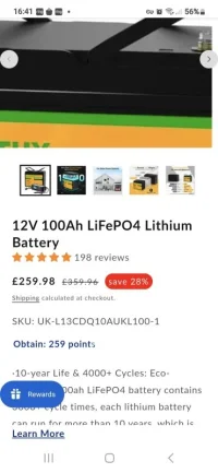

1000006541.jpg I've seen this, I assume this would be ideal for what I need then??

View attachment 265295 I've seen this, I assume this would be ideal for what I need then??
For £40 more you can get a Fogstar Drift which is a much better battery with UK support. That is an offer price that will likely go back to the normal £369. Or for £40 less you can get their Eco version which doesn’t have heating and a few other features.
