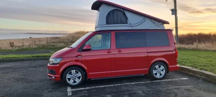

Hi i'm in the same dilemma - Standard or Aurora - does anyone have a side profile pic of their LWB van with a standard version so I can compare?
