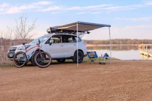

@VanDamMan how do you use that awning on the trailer? It looks a bit low to sit under or do you use it so you can sit on the floor underneath it?
Like probably most used to seeing the awning high at the back and lower at the front...however this model is designed for vans as well as suv/cars .. so can be either high or low ...at the lowest point by the trailer its 1.5m ( don’t need headroom when sitting)
No motors ..pulls out ..easy to put up
Not my image

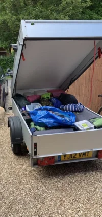

I used to have the same trailer without the vertical side extension. I used the 150cm Thule wing bars on mine. I did have a set of slightly shorter Thule bars from a previous car, I think they might have been 127cm and they were too short.
The overhang on the side was just about right.
In my opinion they were perfect as you need some overhang especially if you are putting a few Thule 591 carriers on there. I put five of them on mine and it carried them very nicely. This photo shows the overhang a bit better. The 127 bars wouldn’t even go on with the Thule 757 foot packs so it was a very easy decision.
If I was buying again I would get the 150 wing bars. Those Anssems trailers really are the business, I only sold mine because the T6 swallows everything up, but those trailers are ace.
I have some older 127s and I was hoping I could save a few quid but I am learning there is no saving money in this transporter business. Hopefully I can get the trailer in a few weeks and have a play. Cheers for the photos and info.
Hi @VanDamMan i am looking at getting the same trailer and roof bar set up, would you happen to remember the length of the EVO bars you got. I am not sure if the 127cm will be enough as the internal width is 126cm? thanks
Sorry for not getting back sooner…..Yes 150cm will fit perfectly ( as @Broadside mentioned :thumbsup: ) ……We add some wrap to colour match the van…just a bit of fun:laugh:
