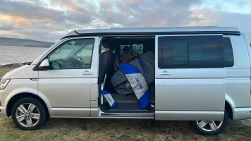

I'm glad you have updated this post with more photos of your build. It now looks fantastic, so well done! :)
Thanks @hoggle appreciate the interest. It’s actually nice to review what I have done since I bought the van and how different it is to the Kombi it started out as. And of course we have been all over the place camping. Lots of Scotland of course but also Pembrokeshire and the Midlands. Currently parked on the sea front in Balintore having enjoyed a lovely meal and couple of pints at the Balintore Inn where they welcome customer Campervans overnighting. Throughly recommended
It's certainly different to when you started. I love seeing what other folk have done themselves to their Vans. And there's a lovely circular walk from Portmahomak to Tarbat Ness Lighthouse. Nice part of the country.
