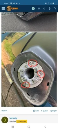

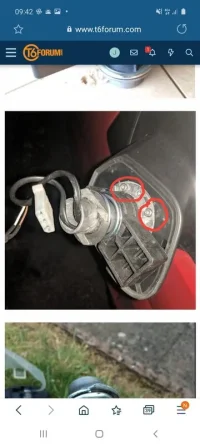

Was going to start a new thread but just found this one, I'm after a little help....
My mirror is hanging off (well it was its held on with gaffer tape at the minute :whistle:).
It has broke the aluminium casting as below and left just the 3 torx screws in (stole these pics off here);
Screenshot_20200825-094247_Samsung Internet.jpgScreenshot_20200825-094807_Samsung Internet.jpg
1. So if I order the repair part above that will fix it?
2. The plugs are contained within the door card then too? Can't see anything on the mirror and hence why it is gaffer taped on at the minute (I'm away on hols so don't have any tools).
3. Also the upper cap/plastic moulding (that is colour coded to the body) has gone, where's best to source one of these, mine are/were gloss black so don't mind if I can get a pair of ready painted gloss black ones?
Cheers.

I just ordered the metal bracket off of ebay for about 10quid and replaced it. I did look into replacing for electric ones but for now I thought a 10 quid fix was the better option.
