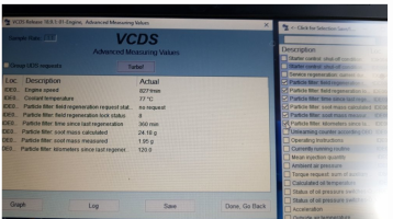

The measuring blocks are greyed out. I have found a screen that shows crank and camshaft signals along with fuel pressure.
Engine turns over at normal speed and sounds normal.
I’m quite new to vcds so will do some studying.

egr pipe was weeping water from around the crack, guessing that’s normal from burning hydro carbon. It’s leaking slightly where the pipe fits into the flange. I’ve taken some pictures of vcds before and whilst cranking. No injector value ?? Battery is ok, voltage low as been cranking a lot.

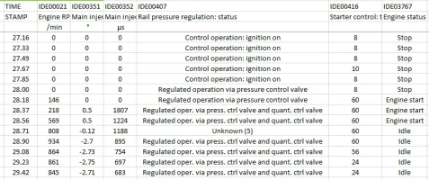

EDIT: a snapshot of a successful engine start

MMI, I have attached the log but I can't open it.
Thanks - strange indeed. As already seen on your screenshots - it seems that injectors do not open at all when they should (red in the picture), neither activity on timing (see picture in my post above).
There is airflow, fuel pressure, EGR turned off, throttle open,... but no fault code!
Forum compressed the picture - a better copy in PDF-format attached.
