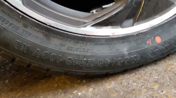

The load ratings are.. (grabbed from Are These Wheels Suitable )Just ordered a set of 18" sportline alloys from the forum shop and wondered if these winter tyres would be ok?
R18 245 45 load 100
NOKIAN WR D4
