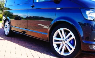

Here's mine so you can see they don't look bad.
Even if you spent £1500/corner having custom cnc machined magnesium alloy billets formed, I doubt it would look much better. Spot On :thumbsup:, just right for a VW Van
