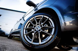

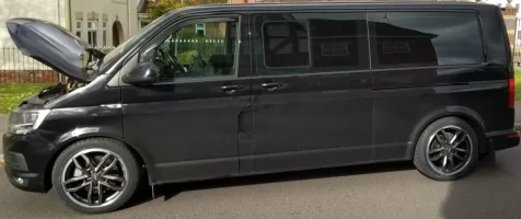

18” or 19”?
I'm a bit confused really, 102 tyres (rated to 850kg) x 4 = 3400kg, so my T32 gvw is 3200kg, doesn't that take it just under?
My wheels are definitely rated to 860kg a corner, no issues there.
It’s the actual axle load ratings that matter and your axle ratings will add up to greater than the total GVW. Your axle rating is probably something like 1720kg.
It's based on half the axle loading.
T32 axles are 1710kg and 1720kg, so 855kg front and 860kg rear.
That's why VW fit 255/45-18 103 to T32.
I've emailed ABT to confirm, if my converter has fitted incorrectly load rated wheels/tyres then they are in for a world of pain.
I'm sure you won't but don't let them fob you off. :thumbsup:
I suspect if they are wrong he'll go down the route of saying 'well those are the wheels you asked for, I only fitted what you wanted'. But as the self proclaimed conversion experts you'd expect them to know the fecking difference between 102 and 103 rated tyres.
I was told by the converter you can't buy the ABT DR19 wheels naked anymore, they come with tyres, so that may be his other get out clause. Blame ABT and claim he didn't realise.
